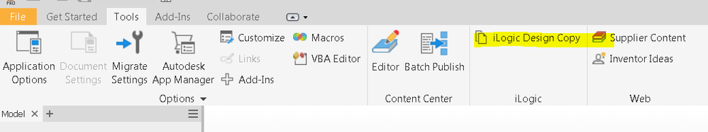

Background:
I'm trying to create a standard template for our assemblies so that you just have to change the size of the parts using an iLogic form. I also have it linked to an .idw so that we don't have to go in and detail each new assembly. The assembly code makes reference to the specific files/parameters that the parts are in/have.
The issue:
So, when I do a save as/copy the files over to make a new assembly, the code doesn't change with the new file names and therefore my code doesn't work correctly. Is there a way to code it to where it pulls the new file names from the parts,  or in general a better way to use this file as a template?

Curtis_Waguespack
Hi @mBASOM ,
As mentioned, you will want to rename the components in the browser so that the occurrence name is "stabilized" and remains the same regardless of the file name change.
You can call them what ever you want, as long as they match the names in the code. A good way to know that they are renamed is to remove the colon and instance number from the name .
example : Grounding Tab:2  becomes Grounding Tab2

Curtis_Waguespack
@mBASOM wrote:
Are you saying that I can change the file name and nothing else and that will solve my issue? Does changing the file name un-link those files so that if I make a change in one version of the part it won't affect the "standard" version? The way I've been doing it is copying the assembly and all of the parts and renaming them in the file explorer. But I figured you had to go and replace all of the files in the assembly with the renamed files.
Nope, I'm saying change the browser name (aka Display Name) and then make sure the code matches those names, then when you do change the file name during a copy from say, iLogic Grounding Tab.ipt to 999-31 GTab.ipt or something along those lines, the code will still work because it is looking at the browser name, and the browser name will be "stable" and not show the file name.
Also when you close all files you can find a tool called iLogic Copy Design, that will copy and rename the files for you, and then your new assembly file will be looking at the new named part files without you having to replace them manually.

Curtis_Waguespack
Hi @mBASOM
No need to apologize...
There is not really a need to rename the browser node in the part file, since the part rules are never looking at that. In fact I prefer to leave those alone (note to set them back you can edit them and just delete the name, and inventor will reset back to the file name, so you might want to do that)...
Where you want to have the browser names stabilized is in the assembly file. This is because the assembly rules must use the browser name  (aka "occurrence name" or " occurrence display name") to find the target file.
In this image I've named all the occurrences from inside the assembly, but if I looked that folder I'd see your original file names.... Once renamed, I just make sure the rules are looking at these name, and then I can copy the assembly and parts 1000 times and the rules still looks for Darryl or Bob, etc.
