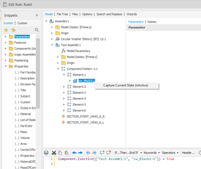

A quick tip on this: You can extract the MakePath syntax by using the Model tree in the rule editor, and right clicking on the target component, and then choosing Capture Current State.
Note the curly brackets are a shortcut for assembly the array syntax that we do using the MakePath function.

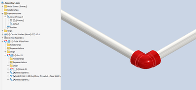

"Tube & Pipe Runs" refers to the parent tube and pipe assembly within the main/top assembly. That is exactly how iLogic references it when you right-click a part/subassembly and choose "capture current state".
It is also how it appears in the browser (see attachment).

This worked for me and ran with no error. Note the View Rep needed to reference Master even though it was called Primary in the model.
Component.Color({"Tube & Pipe Runs", "Run 01" }) = “Red”
Component.InventorComponentInThisContext("Tube & Pipe Runs").SetDesignViewRepresentation("Master")
InventorVb.DocumentUpdate()

I was able to use this to set the elbow color from the top level assembly as shown. This assumes that "Red" is an appearance in the assembly document already.
Dim oAsset As Asset
oAsset = ThisAssembly.GetAppearanceAsset(assetName := "Red").Asset
Component.InventorComponentInThisContext _
("ASME B16.11 90 Deg Elbow Threaded - Class 3000 1/2:1").Appearance = oAsset
Message 9 of 10
