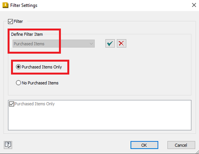

I am trying to write a line of code that turns on a Part List Filter, in particular the Purchased Items Only filter.
I can't (for reasons unknown to me) apply the correct Variant Option to the below code
How do I write this Variant into the FilterSettings.Add() code?

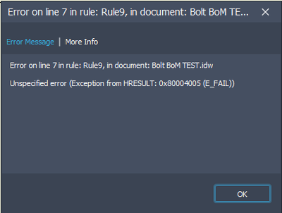

Tim_Mulder
Thanks for the reply Wesley,
For some reason when I run your code I get an Unspecified Error on line 7.
This is the part of the code I am interested in as well (applying the Purchased item only filter)
Any ideas?
Kind Regards
Tim
