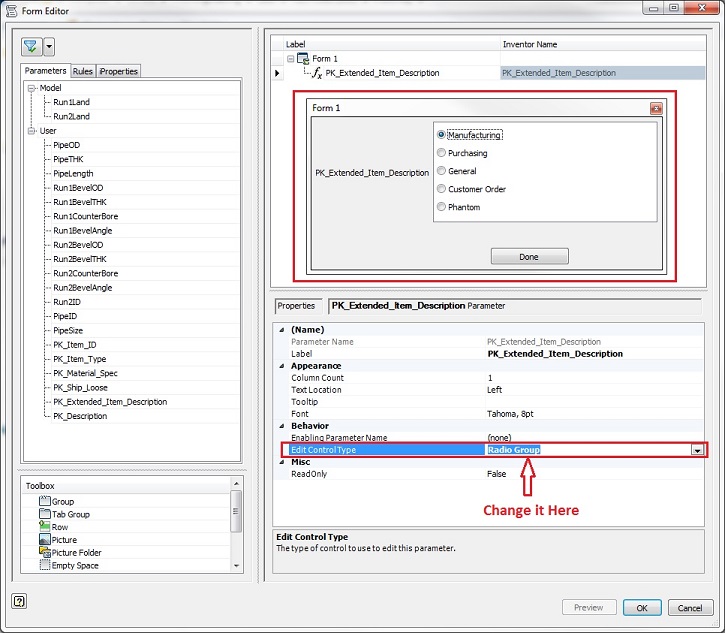

I need to create a form with several options, corresponding to parts to load/unload. Only 1 checkbox can be activated at a time, so when I check a check box, the others have to be unchecked. In VB this should be radio buttons, is it possible to have the same issue in iLogic with checkboxes ?

You do know that in the form you can chose radio button instead of check box?   Just have to use a multi list in the parameters.
I hope this helps.

Thanks for the VB link, this allows more posszibilities than iLogic but is not usable by an Inventor user. I think I'll use it for advanced dialog boxes, but it will be totally in VB instead of iLogic.
For the Radio button option, effectively I missed it, it is exactly what I need for my application.

How could you get in that form options?
My iLogic Forms are simpler than that.
Could you explain step by step how to add the radio button option on a ilogic form?

I've created a screencast video but impossible to publish it... Try : https://autode.sk/2rcWTwq
Method :
-create a multivalue parameter "Options" in Fx table
-insert the parameter on a form
-in its properties, select "radio group" (see above)
-create a rule to test the value :
Select case Options
Case "Value 1"
Case "Value 2"
End select
Hope that's helps !
