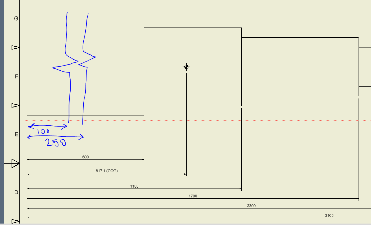

I've been trying to automate break feature in one of drawing.
Please check snap I've attached below:
As shown in 1st snap I need to make a break which starts at 100 mm from left edge and ends at 250 mm from the same left edge. I've been working on model scale of 1 : 8. Model overall length is 3100 mm.
I understand that ilogic works on cm units so I've placed start and end points as 10 and 25 respectively in code. (Please check below code)
It's not giving result as I wanted.  I've posted result snap as well. (Please check 2nd snap) !!
Could anyone please help me understand that how these start and end points work ? in which unit do they work ? and also I believe they depends on scale as well but not getting how to set these points.

I believe that not only are you dealing with 'database units', but also with 'sheet space' distances rather than model space distances, and scale factor, as you suspected.  I'm thinking you would need to get the view's scale to a variable (Double), then multiply your expected offset values by that scale variable, before supplying them to the Add function.
The other problem, is your trying to judge where geometry is going to be within a view, by using the view's bounds, which isn't usually very accurate.  It would likely be more accurate, and more stable if you actually referenced a DrawingCurveSegment/DrawingCurve representing a model Edge, then maybe its mid point or end point position within the view.  It will be quite a bit more difficult to set-up that way, but drawing automation usually is a lot more complicated to do by code than it is to do manually.  You could probably assign a name to the Face or Edge in the Part document, then retrieve that Face or Edge in the rule, then determine which DrawingCurve in the view is representing that Face or Edge.  Then check its geometry type (likely a line), and create a Line variable and set this object as its value.  Then get the end point or mid point property of it to use in the break point placements.

Hi @WCrihfield ,
Thanks for the response and helping me understand this.
Apparently I'm new to this CAD automation world.
If it's not a lot to ask could you please write code for this ? Not very much detailed but just to get an overall idea of what you're suggesting.
What I understand here is that I need to make 2 "named edges" (Rather can I make planes here ?) in part file for start and end point. Then retrieve these 2 lines (or planes if possible) position in drawing rule and make them as start and end point for break operation.
Please correct me if I'm wrong here. Your simple code to understand this thing will be appreciated. Thanks in advance.

Another method to automate the break points. Add two work points to your part called Break Start and Break End and your drawing will add a break using those points

hi, how did you put distance from edge of the assigned entity name to the breakpoint feature. I used the code by WCrihfield, but the breakfeature generated is from end to end point of the part. That's why my part looks like this.
Message 10 of 10
jdasilvaS39UQ
No, it has to be a workpoint with how the code is set up. It translates the workpoints from your model to centermarks on the drawing. Those points are what are used to determine the break location
