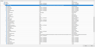

I trying to get Sketch Definition from Hole Feature.
Considering that it is the same document:
VB:
Addin c#:
As you can well see: in the second image the sketch throw me an exception that is not there in the first one.
This is Model, anyone have the same problem?
