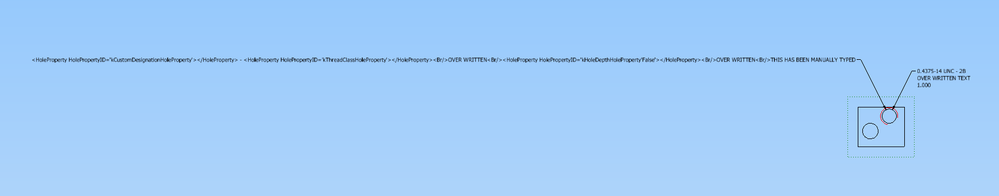

jamieking89
Hi @WCrihfield
This is great. Definately something i can use. I have 2 questions though, if my hole callout has "THRU" as default the rule wont pick up on this text (this is good) however it wont pick up on any text after either.
Rule doesnt pick up on the text after THRURule doesnt pick up on the text after THRU
Also if the rule is run twice without the hole callout being corrected it will add THIS HAS BEEN MANUALLY TYPED twice, and again for each time the rule is run, is there a way to tweak this so if  the warning message has already been included it wont typed it multiple times? Also this effects the rule which will clear the text, if there are 2 lines of THIS HAS BEEN MANUALLY typed it will only get rid of the last line and if the rule is run again wont delete anymore?
Apart from those minor things the rule is great and is exactly what i am looking for, thank you very much for your time and help with this.
Jamie

Hi @WCrihfield
This is extra but the attached screenshots are for different scenarios im wondering if could also be captured, one being if the text that is over written inside of 2 XML callouts <> TEXT <>
And also if text is embedded inside again but the last line is over written? It spits out alot of XML information if the rule is run and the second rule to delete this text then wont work. Any thoughts?
Your input is much appreciated.
Cheers
Jamie

I see the problem.  When you edit the note, using the Edit Hole Note dialog, and you use your [Enter / Return] keyboard key to go to the next line of text (so your cursor is waiting on the next line), it is putting a "<Br/>" ('break line' in XML) at that point into the FormattedText.  Then whatever additional text you may or may not type on that new line.  My code was getting rid of the text after that additional "<Br/>", but not that last "<Br/>".
     So, it sounds like we need to add some additional checks in there.
  • We need to check if "<Br/>" is the last text in the FormattedText, if so, delete it.
  • It sounds like we may need to establish a list of String values that are OK to be at the end.
    • "THRU" being one of those String values
  • If there is text after the last ">" character, then also check if there is a "<Br/>" just before it.
    • If that is the scenario, delete both? (Because "THRU" will never be right after a "<Br/>", right?)
    • Will there ever be any text after the last "<Br/>" that is not a 'manual entry'?
