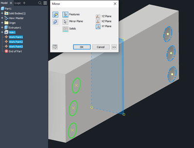

Let's say I have a solid part with a hole feature that has 6 instances of holes. Now I mirror that hole feature to give me 6 more holes on the opposite side of the part face.  How can I programatically get the 6 original holes & the 6 mirrored holes so that I can get the center points?  What I'm trying to do is create a CSV file that contains the x,y & z coordinates of all 12 holes.  Thanks for any help...

I would include the points you are looking for as part of the hole features, or maybe use an iFeature for this.
Easiest way to do this is to use a "Centre Point of Loop of Edges"
Mirror the holes and the points together
Then run the iLogic code that I have written for exporting points to CSV or TXT, it looks something like this:
I've tested it and it works with mirrored points.

Hi @NickBrege
I havn't done a lot of testing but how about this approach? 🙂
If the mirror plane is a workplane and the hole feature is based on sketch points it should work?
