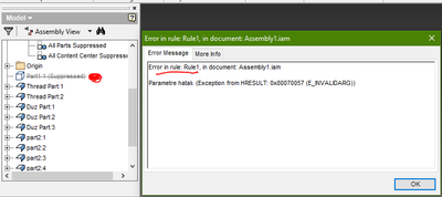

Your code is working perfectly. But i just have one more question. I wonder if you can make it work when there is a suppress part in the assembly?
Because when I have a suppress part in my assembly, your code does not run.
Message 8 of 10
Andrii_Humeniuk
No problem, try this code:

Message 10 of 10
Andrii_Humeniuk
It looks like you are using an older version of 2022 Inventor. I hope the new changes will help you.
