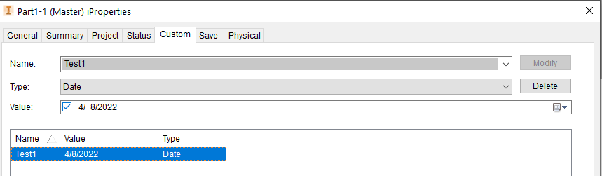

The main question was how to add a custom iProperty as a Date type iProperty, and/or how to change an existing Text type iProperty to a Date type iProperty.  We have already demonstrated above that in order to create a Date type iProperty, you must set a Date type Value to it when you create it (not just a String that looks like it contains text formatted to look like a Date).  The missing bit of information here is that you can simply change a Text type iProperty over to a Date type iProperty, by simply changing its Value, as long as the new Value is of Date Data Type.
For example, even if I created a Text type iProperty using the iProperties dialog Custom tab like this:
Then, if I simply want to change it's type from Text to Date by using an iLogic rule and the iProperties.Value() iLogic snippet, I can do so like this:
iProperties.Value("Custom", "Test1") = Now
Then when you look at that custom iProperty in the iProperties dialog, custom tab again, you can see that its Type setting has changed from Text to Date, and you can see that the new Value is an actual Date like this:
And just in case you may not have known, if the custom iProperty does not already exist, then when you use that iProperties.Value() snippet to set the properties Value, it will automatically create the custom iProperty for you.  The same is not true if you are just trying to read the current value of an iProperty though.  If it does not exist, it will throw an error.
