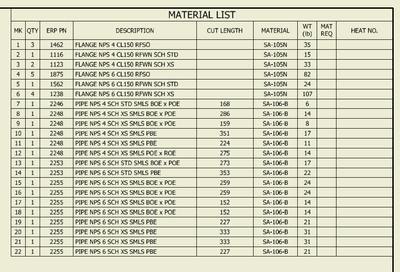

I am looking to have a modified version of the code below to retrieve the item numbers of the parts that are in my sub assemblies and make custom iproperties that lists those item numbers. I will explain below.
So I have my main assembly with a number of subassemblies. Each of those subassemlies is composed of two parts - called "Flange" and "Pipe". I would like a "Flange Item" and "Pipe Item" custom iproperty created in each of the subassemblies (not the parts). The values of these will be equal to the item number of the part as listed in the Parts Only BOM view of the main assembly.
For example, in the screenshot of my model tree below, the W06-065375 ROOF NOZZLE N3 component has components "Flange" and "ROOF NOZZLE PIPE". I am trying to create custom iproperties in the W06-065375 ROOF NOZZLE N3 subassemly with the item numbers of the two parts with values from the Parts Only BOM View.

My main objective is to fill up the "Components (B,C)" column in the table below. This column will be the item numbers of the parts making up nozzle tags. For example, N2 is composed of 1 and 7.  Those items are listed in another table called "MATERIAL LIST". I hope this makes sense.

Thanks @WCrihfield ! I tried it out and it works!
