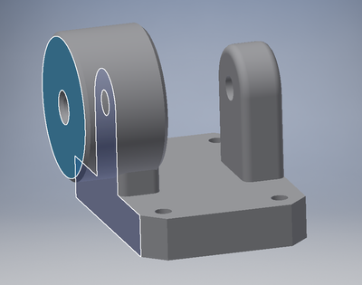

I am trying to create two constraints on two details in an assembly.
I created a constraint on cylindrical faces.
Similarly, I created a constraint on two flat faces, but the wrong flat face is selected on the first detail.
I need to select a flat face inside the cut of the first part, but I do not understand how to do this.
Please help.
What am I doing wrong?

Instrad of iterating through all faces of the occurrence you could specifiy the face number like so :
Dim oFaceDetail1 As Inventor.Face = Detail_1.SurfaceBodies(1).Faces.Item(x)
x is the face item number, to get it you could use this rule in the part document :
Sub Main
Dim oDoc As Document
oDoc = ThisApplication.ActiveDocument
If oDoc.DocumentType <> kPartDocumentObject Then
	MessageBox.Show("This functionality is only aviable in a part document!", "Error! :C", MessageBoxButtons.OK, MessageBoxIcon.Hand, MessageBoxDefaultButton.Button1)
	Exit Sub
End If
Dim oPartCompDef As PartComponentDefinition
oPartCompDef = oDoc.ComponentDefinition
Dim Face As Face
Dim oFace1 As Face = ThisApplication.CommandManager.Pick(kPartFaceFilter, "Pick Face")
If oFace1 Is Nothing Then
	Exit Sub
End If
Dim oSurfaceBody As SurfaceBody = oFace1.Parent
Dim i As Integer
Try
	For i = 1 To 100000
		If oFace1.InternalName = oSurfaceBody.Faces.Item(i).InternalName Then
			MessageBox.Show("    " & i, "Face internal item number : ", MessageBoxButtons.OK, MessageBoxIcon.Asterisk, MessageBoxDefaultButton.Button1)
				Exit Sub
		End If
	Next
Catch
	MessageBox.Show("Unexpected error occurred!", "Error! :C", MessageBoxButtons.OK, MessageBoxIcon.Hand, MessageBoxDefaultButton.Button1)
	Exit Sub
End Try
End Sub
