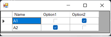

I've managed to get a bit closer to what I want with approach of disabling existing checkbox with the code based on CellPainting Event handle:

Now I can clear disable checkboxes not only in the first row.
But I still worry about the fact that the sub is called 24 times for single cell and get to endless cycle (at least without crashing) if un-comment the code lines related to the checkbox in a first row ...
... I believe it will crash on real check box chart with dozens checkboxes.
Any ideas?
