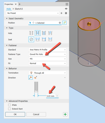

So, one thing we did for "custom holes" that we wanted to control, was a new style to the Excel Spread sheet that IV reads the hole data from.
In this case, we wanted to make standard dowel pin holes based on the metric size. So, I added these rows to the sheet and filled in the Size, Shaft Diameter, and Head dimentions appropriatatley...
so, when I fire the hole command in IV, they show up like this now.
Where it automatically assigns the diameter based on the metric size and fit.
Using this method, you can just insert more rows to the desired new styles you are looking for. Really, as many rows as you need.
RNDinov8r
So what you see there, are two styles of dowel pin holes..one for thru holes (or blind) and one for holes with breathers. Say for example I put a Ø10mm dowel pin that is a press fit into a 50 mm thick piece of metal...I don't want to bore a 10mm hole all the way thru, so using the C'Bore feature, I can set my C'bore to the dowel pin hole size, then set a depth, and then the breather hole is just a smaller thru hole. My hole note can then tolerance the breather hole to say, ±.010" while the dowl pin hole is held to within 0.001".
