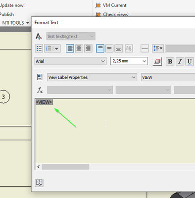

Can I made change all detail view to this setup with Ilogic code ? I want make remove both the Letter  and add Smooth cutout shape, Full Detail Boundery and Connection Line

You code did give a error  but I fix it ... you have to take
oDetailView.DisplayFullBoundary = True
 before
oDetailView.DisplayConnectionLine = True
but I still missiong one thing I need to delete the Letter on the last one
If do that with right clcik on it--- select text and delete it all
can you add that to the code ?

Darkforce_the_ilogic_guy
it does not work . I don´t think you can just turn if of...  I need to delete it. This is how it looks after I run the run .. have not remove the Letter A as you can see

I ended up with this code that works
