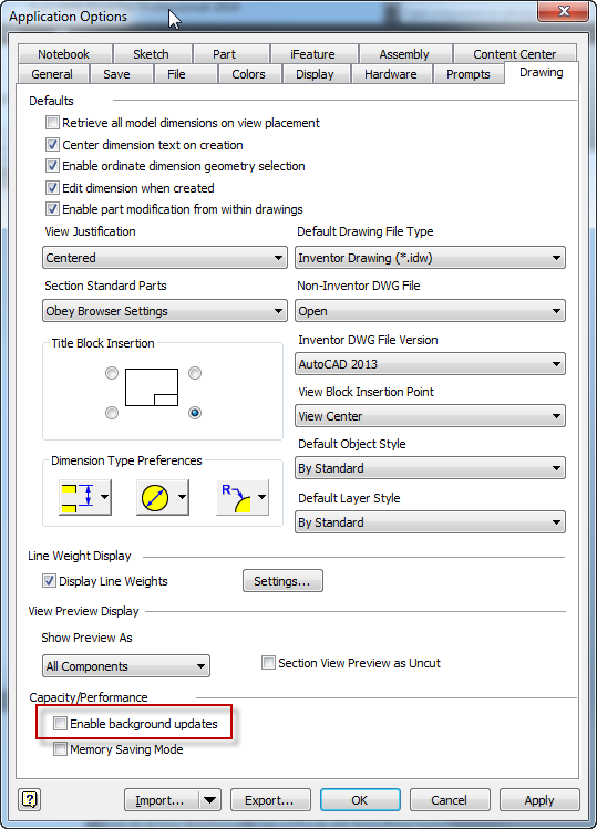

I'm using the PDF Translator AddIn via the API to export drawings to PDF. But when I opened the PDF the views appear blurred.
I thought the reason could be that the drawing is exported before being updated. However I tried it, but it still didn't work. I also tried with "DrawingDocument.MakeAllViewsPrecise, but nothing has changed.
Any suggestion?

are those shaded views? are they using bitmaps with low resolution maybe?
jR0sal3s
this is what i used....resolution at 400 or set it higher.

Thanks for your reply,
No, the drawings don't have any shadows. They contain only white and black lines.
It seems to me that the root of the problem is something related to updating the drawing document.
I recently did a test to check this fact. Firstly, I created a "Sub" called "UpdateTest" so as to update and save the drawing. Then, I executed it. After that, I executed another "Sub" in order to export the drawing to PDF through the API. Then, it worked. Any blurred view appeared in the exported PDF.
However, if I execute the "Sub Update", then the views will appear blurred after exporting PDF.
I cannot completely understand it, it should be something related to how my code is written and it is executed, because the resolution isn't the issue.

bshbsh
I used to have that problem when the option "enable background updates" for drawings is enabled. inventor just starts those background processes (something like invviewcompute.exe or so) but the macro continues to run, doesn't wait for those processes to complete. In my case, I disable this option in my macro before updating the views, then re-enable it after the pdf is exported.
dibujocad
Hi bshbsh,
Thank you so much for your tip. It finally works!! :slightly_smiling_face:
