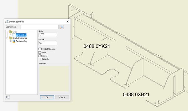

theo.bot
If you use skeched symbols in a drawing, you can place them with a invisible leader. This keeps your symbol linked to the component that you want to reference. you can reposition the symbol but no leader will be visible.

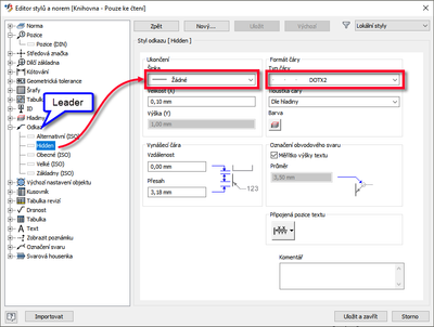

Michael.Navara
You are not able to remove a leader from balloon, but you can set leader style of balloon to "almost" hidden (No arrow, line style doted) In this case you can use standard balloon for annotation. Inventor has connected component and the visual style is acceptable for viewing or printing.
Sorry for printscreen from CZ version

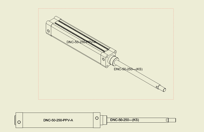

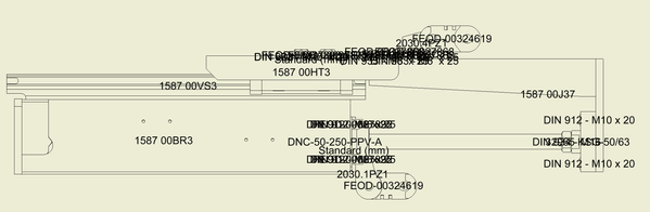

mat_hijs
@theo.bot I'm running into a problem now. The code works perfectly as long as the components you want to annotate are parts. But if you want to annotate subassemblies it'll just put the part number of one of the components since that's what's selected by the drawing curve. Do you have any way around this?
Message 14 of 15
theo.bot
@mat_hijs
The challenge is the definition of the sketched symbol, it gets the partnumber of the attached geometry. So an alternative way would be an sketched symbol with prompted entry, that you fill with the part number of the occurrence, the sub assembly.
I created a new sketched symbol with a prompted entry to test it, and it works.

Message 15 of 15
mat_hijs
So if I understand correctly, this will be able to annotate everything correctly at first. But once everything is placed there is no link anymore? I don't really see a way yet to update the tags after they have been placed. Or more specific, updating the tags won't be a problem, but how will it know where it should get its information from when there is no link at all anymore?
I'm beginning to think that I might have to go back to either manually placing tags probably with AutoCAD blocks or to annotating everything in Revit.
