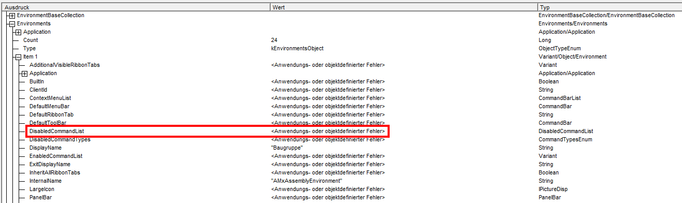

I think that the DisabledCommandList does not exist... in the VBA editor it looks like this:

yeah, this seems to be the problem. Even if I change my code as jjstr8 suggested, this line throws the exception:
I also had the same idea to make my own DisabeldCommandList, but I get the following error:
in english: Cannot create an instance of the abstract class or interface 'interface'.
(I'm not so good with interfaces and abstract classes)

@bindlmi: Use the collection from Plugin.m_inventorApplication.UserInterfaceManager.Environments in your foreach
Message 15 of 15
bindlmi
Awesome, that's it! 🙂 And it even works with the ButtonDefinition 😉
