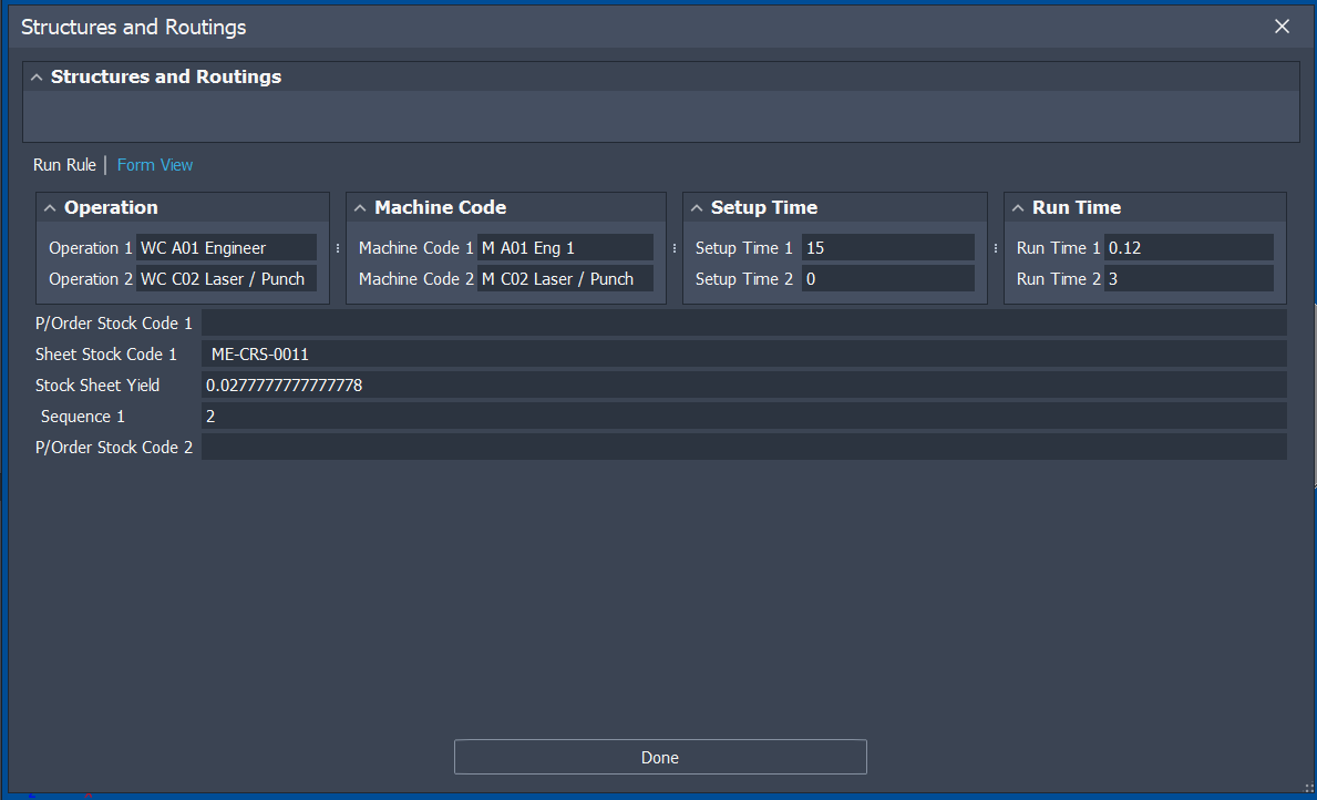

I have a rule (with the help from many on this forum) that actually runs multiple rules back to back, all of the iProperties created need to be linked to a common number 1,2,3....what I have works however I think it could be easier and a bit more intuitive. There will be several other Rules added along the way to create other iProperties/Values

It sounds like you might be up against the limit of the out of the box input and list boxes. Maybe you might consider using VBA form or if you have visual studio a VB.net form. With these types of forms you can present the users with the information in one form so a little easier on the eyes.

Hi @bbrumfield.  I believe you mentioned a need to be able to share common data across multiple iLogic rules...Is that correct?  If so, then you may be able to take advantage of either the SharedVariable interface tools, or the RuleArguments interface tools, along with the NameValueMap object, within your iLogic rules.  These tools are specifically for helping us share data between iLogic rules.  Here is a link to one of my contribution posts about sharing data between iLogic rules that you might find helpful.

Thank you, Ill do some experimenting with this, I think if I'm reading correctly namevaluemap should do the trick. I'm working on a form to run the "Add Op Rule" screen shots below (Work in Process).
As you can see in the form view there is number sequence for Operation, Machine Code etc, which will be needed for mapping to CadTalk which in turn will save the information to our ERP.
