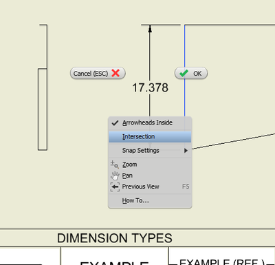

When I need to do an intersection dimension I usually click dimension then select the first line, right-click and select intersection, select the second line, then select the third line to dimension off of. How do I automate this. I have found similar ideas but they are a little more complex than what I wanted to do. See the image below for what I mean by the intersection option. Also trying to do this specifically with a macro and not an ilogic rule.

What you need to do is to create a geometry intent for the intersection point between the two drawing curves.
Here's an example:

 The macro will ask you to first pick the two curves that you want to get the intersection point of. Then pick a third curve that you want to create the dimension from the intersection point to.
Notice how I create the intersectionpoint geometry intent by calling CreateGeometryIntent using the two curves as arguments :slightly_smiling_face:
