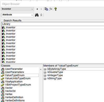

I have another problem with attributes.
Fore some reason attempt to add boolean attribute fails.
This line brings up an exception
 occAttributeSet.Add("_0003Associative", ValueTypeEnum.kBooleanType, True)
because of he attribute type.
Why boolean attribute does not work?

Object model looks like ".Add(AttributeName As String, ValueType As ValueTypeEnum, Value) As Attribute" and ValueTypeEnum only has {kByteArrayType, kDoubleType, kIntegerType, kStringType} so set as an integer with value 1 for true and 0 for false and a boolean variable should be able to read/convert/use that just fine.

Hi @clutsa.  Which version of Inventor are you using, because when I look at the online help page (2022 help) for the ValueTypeEnum, I see 5 variations available, and one of them is kBooleanType (14597).  And I still see it that same way for 2018 & 2019 online help.
@Cris-Ideas
However, I just tried assigning a Boolean type attribute to one of my test files that I have already assigned a bunch of named entities in, and also got an error.  It's just one of those "The parameter is incorrect." error messages though, and just points to the line where I am attempting to add the attribute, with no further explanation.  I can assign other attributes to the selected face, within the same attribute set, like Double type, but when I try to add a Boolean type attribute, it fails for some reason.  I even tried using a predefined Boolean type variable as the value, instead of True or False directly, but that did not make any difference.  I'm still not sure why though.  There is no documentation on the AttributeSet.Add method's online help page about not being able to create Boolean type attributes.  But there is a page called "Introduction to Attributes and AttributeSets", which talks about them, and on that page it mentions all the other 4 types, but not the Boolean type.  If we can't create boolean type attributes, they should update the Add method's web page to indicate that, and maybe add something to the pop-up help text to help avoid similar issues in the future.  I do know that the ValueTypeEnum is used in several places, so that type may just be available to other situations where it is used.

I see what you mean. The help page does list five values but the Object Browser still only lists four. When adding iLogic code I'm prompted that kBooleanType is an option but when adding VBA code I'm not. That does seem like error.

I mentioned this in Message 4 above, but I know they also use that ValueTypeEnum in other situations also.  Below are all of the Links I found where it is being used within the 2026 online API help documentation.
All these are Attribute related:  Attribute.ValueType Property , AttributeSet.Add Method , & AttributeSet.AddAttributes Method
These are Content Center table column related, and they do use the Boolean one:  ContentTableColumn.DataType Property & ContentTableColumns.Add Method
These are MiniToobar related, but do not include the Boolean one, just Double & Integer:  MiniToolbarSlider.ValueType Property & MiniToolbarControls.AddSlider Method
So, the Boolean variation is being used by the ContentTableColumn, but apparently not by Attributes or that MiniToolbar control.  And I know that the ByteArray variation is being used by the Attributes system, for storing internal iLogic rules and iLogic Form specs within the Document.
In Message 6 above, I mentioned that this would be a good 'idea' to post in the Inventor Ideas board, and so I just did a quick search in that area, and since I did not find one, I just made one myself.  I will post the Link to that Inventor Idea post below, so that it is easy for every one to find, and vote for, so that we can hopefully get this ability either fixed, or added sooner.
