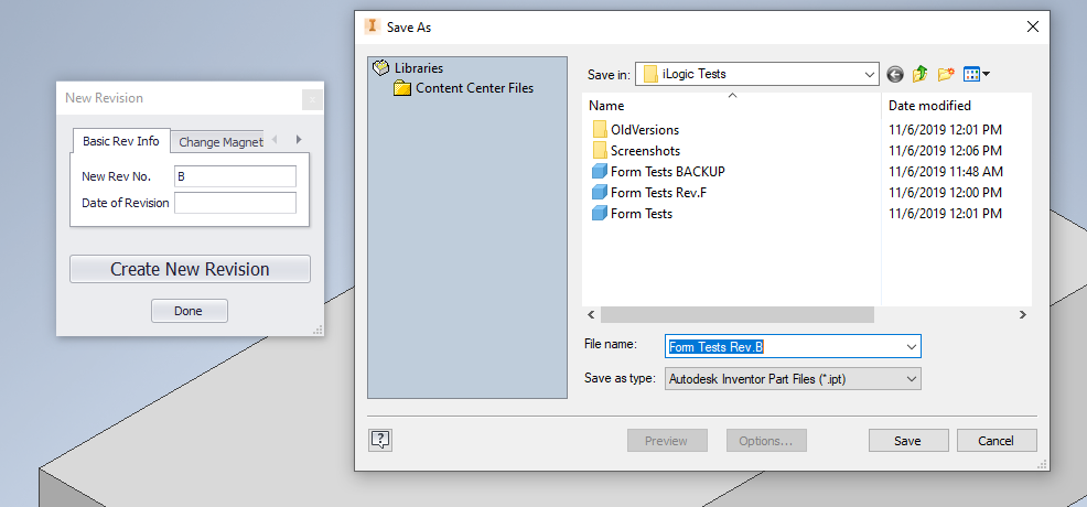

I am building out some iLogic rules to make a current workflow more efficient. One of the small things I wanted to add has already taken far too much time and is throwing errors I cant find the source of.
Basically I just want to have "Revision Form" that would check the current revision, go up by a letter, then change the iProperty  and do a save as "FileName Rev.X". I'm a bit unfamiliar with VB so after not being able to figure out this one I just made the Revision number part of the form. For some reason it only works with certain letters. Rev A doesn't work. Rev B does. C doesn't work, but D and E both do.
I've attached screenshots of all this and I will post the code as text. Any help figuring out why certain letters do not work would be much appreciated.
Rev Rule.PNGFull Doc Title didn't populate. Should Show as "Form Tests Rev. A"Full Doc Title didn't populate. Should Show as "Form Tests Rev. A"Proper Document name Populated.Proper Document name Populated.
Dim revisionFileName As String
'define the active document
    oDoc = ThisDoc.Document
    'create a file dialog box
    Dim oFileDlg As Inventor.FileDialog = Nothing
    InventorVb.Application.CreateFileDialog(oFileDlg)
    'check file type and set dialog filter
    If oDoc.DocumentType = kPartDocumentObject Then
    oFileDlg.Filter = "Autodesk Inventor Part Files (*.ipt)|*.ipt"
    Else If oDoc.DocumentType = kAssemblyDocumentObject Then
    oFileDlg.Filter = "Autodesk Inventor Assembly Files (*.iam)|*.iam"
    Else If oDoc.DocumentType = kDrawingDocumentObject Then
    oFileDlg.Filter = "Autodesk Inventor Drawing Files (*.idw)|*.idw"
    End If
    'set the directory to open the dialog at
    oFileDlg.InitialDirectory = ThisDoc.WorkspacePath()
    'set the file name string to use in the input box
	revisionFileName = ThisDoc.FileName(False) + " Rev." + newRevChange
    oFileDlg.FileName = revisionFileName
    'work with an error created by the user backing out of the save
    oFileDlg.CancelError = True
    On Error Resume Next
    'specify the file dialog as a save dialog (rather than a open dialog)
    oFileDlg.ShowSave()
    'catch an empty string in the imput
    If Err.Number <> 0 Then
    MessageBox.Show("No File Saved.", "iLogic: Dialog Canceled")
    ElseIf oFileDlg.FileName <> "" Then
    MyFile = oFileDlg.FileName
	iProperties.Value("Project", "Revision Number") = newRevChange
    'save the file
    oDoc.SaveAs(MyFile, False) 'True = Save As Copy & False = Save As
    End If

WCrihfield
I don't see where you've defined what "newRevChange" is.
I asume it's a local variable?
