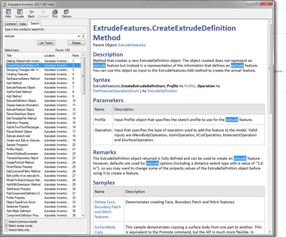

rcolon9E4ZX
I had checked for this a while ago and couldn't find any examples. If you provide the steps for accessing this example, I'd be happy to accept as solution. (From within Inventor?/Ribbon tabs/etc.) This would be very useful for me when using other objects and methods.
Thank you.
rcolon9E4ZX
Also, I am using Inventor 2017.
Access the API Help from within Inventor by clicking the (?) See image below.
Click the Search Tab and search for extrude.
