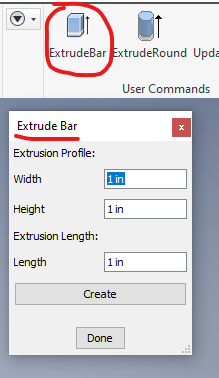

@brendon.serrano That is really interesting code. I am trying to learn as much as possible and I find it fascinating how same thing can be done by so many different ways. Would you mind explaining couple of points?
when you are calling parameters what does those lines of code actually do? do they update the parameters at that point or that make sure that always updated values are accessed from those parameters?
apologies if you find this question very basic. I will also try to find out myself by replicating those parameters.
stay safe and take care.
thanks and regards,
sam
Message 15 of 16
brendon.serrano
@sam No Problem! I have only been using iLogic for a couple months now, but I tend to enjoy coding. My code is a mixture of what I could find and what I could make work. I initially had the parameters in the code because I was using it as an internal rule. When an internal rule has a parameter in it called by only using its name (eg. "MyParam", FYI: You can only do this in internal rules), when this parameter is changed or edited the rule will trigger. I created a form to extrude a bar and I put those parameters in the form for the user to fill out. This way when they could simply fill out a length width and height on the form to quickly create a bar (I did this to make people draw off the origin as much as possible). Anyway, I scrapped the parameters as a trigger by calling them with "Parameter("MyParam")" and added the iLogic code as a button on the end of the form. My final product with this code was using a macro to create a button on the ribbon that would prompt the form and the user inputs desired values and hits create. A bar is then created on the origin planes with the input parameters as its dimensions. Still doesn't work perfectly. I have a bug where when the bar is already created and the parameters are changed, it will no longer be on the origin. I just haven't bothered fixing it yet.
I moved all of my code over to external rules for ease of use on the network, and for legacy documents. Here is my full code and some screen shots of the process. Hope this helps, let me know if you have any other questions.
Dim oDoc = ThisDoc.Document
If TypeOf ThisApplication.ActiveEditObject Is Sketch Then
    ' Set a reference to the active sketch.
    Dim OpenSketch As Sketch = ThisApplication.ActiveEditObject
    OpenSketch.ExitEdit
End If
Dim oDef As PartComponentDefinition
oDef = oDoc.ComponentDefinition
' Get the X-Y work plane.
Dim xyPlane As WorkPlane
xyPlane = oDef.WorkPlanes.Item("XY Plane")
Try
	ExtrusionExists = ThisApplication.ActiveEditDocument.ComponentDefinition.Features("Bar Extrusion")
	ThisApplication.ActiveView.Fit
	Catch
		Try
			SketchExists = ThisApplication.ActiveEditDocument.ComponentDefinition.Sketches("Bar_Sketch")
			SketchExists.delete
			Catch
		End Try
' Create a new sketch.
Dim sketch As Inventor.PlanarSketch
sketch = oDef.Sketches.Add(xyPlane, True)
sketch.Name = "Bar_Sketch"
ThisApplication.ActiveEditDocument.ComponentDefinition.Sketches("Bar_Sketch").Edit
InventorVb.DocumentUpdate()
' Check to make sure a sketch is open.
If Not TypeOf ThisApplication.ActiveEditObject Is PlanarSketch Then
MessageBox.Show("A sketch must be active.", "iLogic")
Return
End If
'set a reference to the active sketch.
Dim oSketch As PlanarSketch
oSketch = ThisApplication.ActiveEditObject
'set a reference to the transient geometry collection.
Dim oTransGeom As TransientGeometry
oTransGeom = ThisApplication.TransientGeometry
' Create a rectangle
width = Parameter("BAR_W") 'Trigger
height = Parameter("BAR_H") 'Trigger
length = Parameter("BAR_L") 'Trigger
Dim oRectangleLines As SketchEntitiesEnumerator
oRectangleLines = oSketch.SketchLines.AddAsTwoPointCenteredRectangle( oTransGeom.CreatePoint2d(0, 0),oTransGeom.CreatePoint2d(width*2.54/2, height*2.54/2))
Dim oSketchLine As Inventor.SketchLine
Dim oDim As DimensionConstraint
oSketchLine = oRectangleLines.Item(1)
oDim = oSketch.DimensionConstraints.AddTwoPointDistance _
	(oSketchLine.StartSketchPoint, oSketchLine.EndSketchPoint, _
	DimensionOrientationEnum.kHorizontalDim, _
	oTransGeom.CreatePoint2d(0, -(width/2 )))
oDim.Parameter.Expression = "BAR_W"
oSketchLine = oRectangleLines.Item(2)
	DimensionOrientationEnum.kVerticalDim, _
	oTransGeom.CreatePoint2d(height+2, 0))
oDim.Parameter.Expression = "BAR_H"
ThisApplication.ActiveEditDocument.ComponentDefinition.Sketches("Bar_Sketch").ExitEdit
Dim extrudeProfile As Profile = sketch.Profiles.AddForSolid
Dim oExtFeature As ExtrudeFeature
oExtFeature = oDoc.ComponentDefinition.Features.ExtrudeFeatures.AddByDistanceExtent (extrudeProfile, "BAR_L", kSymmetricExtentDirection, kJoinOperation)
oExtFeature.Name = "Bar Extrusion"
iLogicVb.UpdateWhenDone = True
End Try
