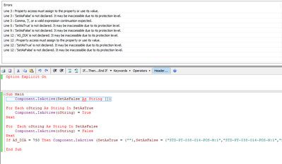

 He gave me an example to get me started but I am unable to get it to work. I keep getting the error "Property access must assign to the property or use its value." I have researched this but can't find a helpful example to guide me. Below is the code I am having trouble with;
Sub Main Component.IsActive(SetAsFalse As String [])
For Each oString As String In SetAsTrue
	Component.IsActive(oString) = True
Next
For  Each oString As String In SetAsFalse
	Component.IsActive(oString) = False
Next
If AS_DIA = 750 Then Component.IsActive (SetAsTrue = {""},SetAsFalse = {"STD-PT-038-014-POS-M:1","STD-PT-038-014-POS-N:1","STD-PT-038-014-POS-O:1","STD-PT-038-014-POS-P:1"})
End Sub

Old request but if you use Option Explicit On (Optional Use) you will find many errors.  The ilogic editor allows for less declarations of object variables but this can lead to issues trouble shooting later. The first error relates to "SetAsTrue" you had not defined what this object was to be in your case a string array or list of string.
