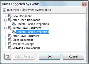

Hi There,
I like to keep the properties of my drawing the same as those of my model. Currently I must remember to hit the "updat copied properties" button in the drawing to discard any old drawing properties and replace them with the properties from the model.
Is there any way to automate this task (perhaps on saving the drawing?) I presume an iLogic rule could be created in the drawing template, just not sure how to go about it.

Here’s an iLogic rule that will do it.
Dim oControlDef as ControlDefinition  = ThisApplication.CommandManager.ControlDefinitions.Item("UpdateCopiedModeliPropertiesCmd")
oControlDef.Execute
For this rule, you have to uncheck the Silent Operation option on the Options tab in the rule editor if you want to see the prompt "This command will overwrite...".
You could set the rule to run on the After Open Document and/or Before Save Document events (using Manage -> iLogic -> Event Triggers).
I hope it helps.

Message 6 of 18
Yeah, it looks like it works great for you.  I wonder what I'm doing differently.
I have the rule triggering only "Before Save Document" due to everytime I open the drawing, it would show as a change had been made.  This would make it impossible to change the state from Inventor.
I also have selected, "don't run automatically" when parameters change.
I've attached the drawing and part template.  These are in progress... and I'm definitely open to any suggestions you may have.  Thanks for the video!

alessandro.gasso
Thanks for reporting the problem.
There was a little issue in the original rule that if you run it manually, the Silent operation option is respected, but, if the rule is started by the trigger, the option is disregarded and you get the prompt.
This is the difference between my video and what you are doing.
Please, replace the original rule with the one below, provided by Mike Deck and everything should work as expected.
oControlDef.Execute2(True)
Kind regards,
