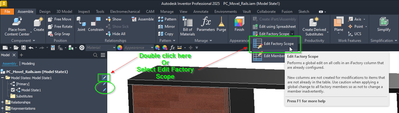

I'm working on an assembly which contains an additional model state "PANEL_SCOPE" and i would like to update it  once i update the "Primary" or the opposite (Update "Primary" when i work on "PANEL_SCOPE").

Yes, i need to update all model states. I've only those 2 in the assembly
CCarreiras
Ok, so it's simple,
If you want to edit all the members, you have to activate the Edit factory Mode Scope and have both pencils blue.
Manually:
A code to pass from Member scope to Factory Scope is and vice versa is:
  • To change the active edit scope to edit member scope, depending on the needs, use:
ThisDoc.Document.ComponentDefinition.ModelStates.MemberEditScope = MemberEditScopeEnum.kEditActiveMember
