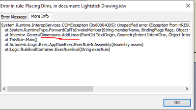

No luck with the code. Throwing error, the SS attached hereby with error type and detail 😞
The error is occuring after this line
	Try
	oOcc1 = oCompDef.Occurrences.ItemByName("overmoulded part:1")
	oOcc2 = oCompDef.Occurrences.ItemByName("LED tape section:1")
	Catch
I am sure about the component occurrences name are correct and this same piece of code with just the difference in name of components is working fine for another component within the same assembly.

I tested with your drawing and the code I initially posted, It is capturing occurrences (that is already sorted), but not able to generate the dimension, It is capturing everything, including named entities and proxies but, just giving an error in the last line, when it has to add the dimension.
