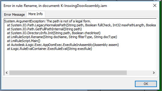

Still not working, I get an error stating "the path is nor of a legal form", I am not familiar enough with coding error to even attempt to fix it myself. It looks like we are on the correct path but still need a little tweaking, thanks for all of the help.
Message 10 of 29
Welbilt_Designer_3
I am going to blame this one on Monday morning, I didn't open the door from the project the first time. The code worked fine the way you have it once I applied it properly. Please disregard mu previous post and thank you for the help.
Message 11 of 29
Welbilt_Designer_3
I spoke too soon, the code runs through all of the rename process for the assembly, frame and door but does not add the renamed frame and door to the assembly. I did alter it some to accommodate the other door component but it wasn't working before I did that. I could send you the assembly if it would help but I don't feel comfortable posting it here.

Welbilt_Designer_3
I don't know what the issue is, but when the code runs it should rename the assembly then the frame and plug. The frame rename is successful but the frame and plug do not get renamed, the save as procedure runs for all components but when it is finished there are no new frame or plug in the assembly. The originals are in the directory so I am at a loss.
When the code is activated in the assembly the results are:
1. Runs the rename procedure for the assembly resulting in a new assembly added to the project folder with a -1 extension.
2. Runs the rename procedure for the frame which does not result in a new frame being added to the project folder.
3. Runs the rename procedure for the plug which does not result in a new plug being added to the project folder.
The screenshot was taken while the frame was being renamed, as you can see the original frame and plug are both available in the project folder.
I can't help but think that there is some setting that is blocking the components from being renamed from the assembly level. Is there a way to get around this?

Hi @Welbilt_Designer_3,
Try the following changes in code.
Imports System.IO
Sub Main()
    Rename("DW-" & 1 & ".iam","Autodesk Inventor Part Files (*.iam)|*.iam", "DW")
    Rename("Frame.ipt", "Autodesk Inventor Part Files (*.ipt)|*.ipt", "Frame")
    Rename("Plug.ipt", "Autodesk Inventor Part Files (*.ipt)|*.ipt", "Plug")
End Sub

Welbilt_Designer_3
Thanks chandra.shekar.g
I appreciate your willingness to help but that didn't work either, I have tried that approach before but it was worth giving it another go. After the assembly is renamed it just runs through the motions of renaming the frame and plug without actually doing anything.
I have tried to run the rename function individually in each component which works fine but if I trigger the process from the assembly using an external rule or a global form I get the same results as using this approach, a renamed assembly but no renamed parts.
Is it possible to provide assembly file (non confidential one)?
I can investigate on assembly.
