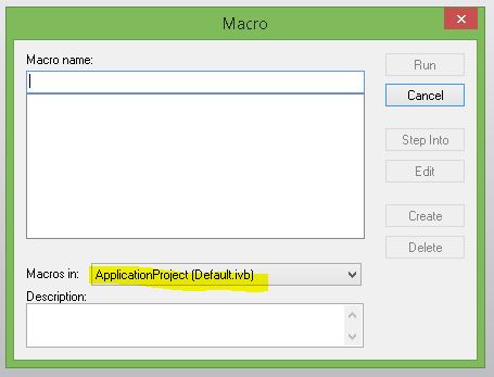

Not sure what happened, or how to fix this. Tried searchiing the boards here to no avail.
It used to be that when I would go to Tools->Macros to run a VBA macro, all the macros in my ApplicationProject (default.ivb) file would already be populated in the list of macros. Now, for some reason, whenever I goto the Macros diaload, there are no macros displayed from my default.ivb file until I select the dropdown option for either All Projects or ApplicationProject. It appears to be defaulting to DocumentProject all the time. Where can I change that? Inventor 2015 x64. TIA!
P.S. I have custom ribbon buttons that access macros in my default.ivb file with no problems. Just a PITA having to select the applicationproject from the drop down everyti,e I want to run a macro that I don't have a ribbon button for!

did you checked this option?

Yes. Whenever I run the Macro command, that window pops up, but the field you highlighted is always blank (didn't used to be that way), so I have to manually click the drop down and select either ApplicationProject or All Projects. There is one instance where it will default to the ApplicationProject, and that is if I have no files open, so it doesn't do me much good in that case either!

Did you check this option in the applicaiton settings?

If you are talking about the location of the default.ivb file, yes, that option is checked. I believe that if it wasn't, none of the buttons I have assigned to macros in that file would function at all? Those still work fine, It's just that if I have a document open, I have to click the drop down to select the "ApplicationProject", which BTW, is the default.ivb file referenced in that application option you asked about if I had set or not
