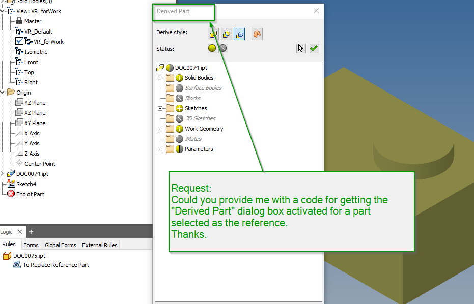

I also need to get the derived part dialog box activated. Please see Figure 1.
Please see Figures 2 and 3 for my other issue.
Sample attached.

To display derived part dialog, try below iLogic code.
    Dim oDoc As PartDocument
    oDoc = ThisApplication.ActiveDocument
    Dim oDef As PartComponentDefinition
    oDef = oDoc.ComponentDefinition
    Dim oDerComp As DerivedPartComponent
    oDerComp = oDef.ReferenceComponents.DerivedPartComponents.Item(1)
   Call oDoc.SelectSet.Select(oDerComp)
    Call ThisApplication.CommandManager.ControlDefinitions.Item("PartEditDerivedPartCtxCmd").Execute
