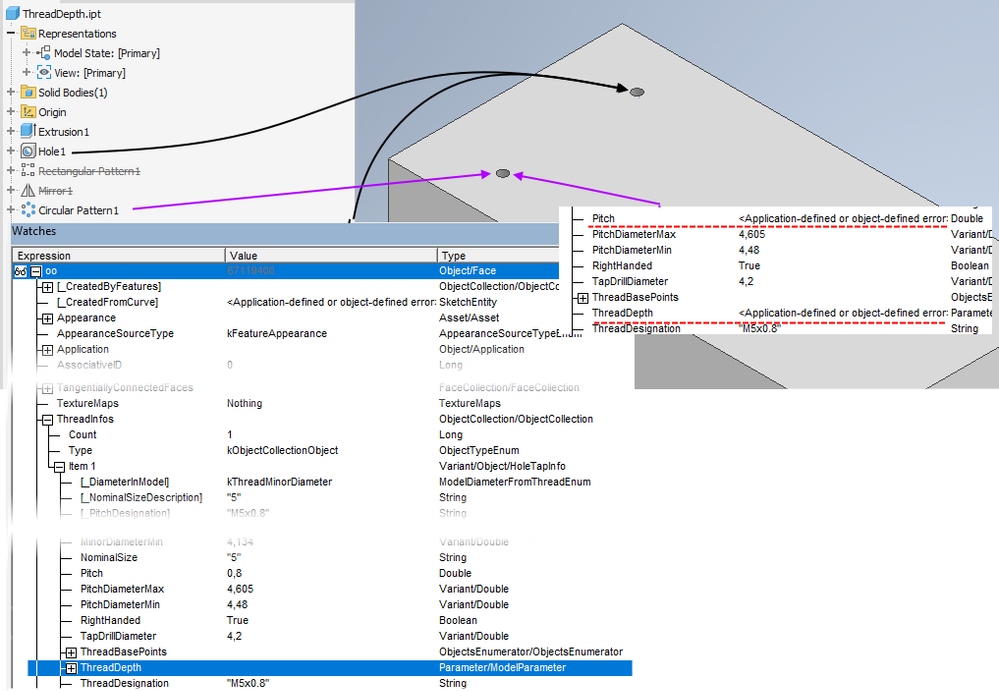

In Inventor 2025/26, I can't read ThreadDepth from pattern faces (tapped holes). All other values are inherited properly. The pitch is also affected. My VBA object watch looks like this:
I attached a part with a rule to show the behavior.
Is this a bug?
