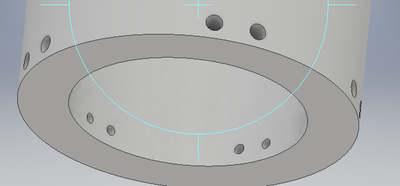

Hi all,
When I am using the circular pattern feature, pattern is getting created but the holes are not placed at equidistance.
As you can see each hole is not equidistant radially from other hole.
But I want the result as this.
// The code for reference is as below
//holy = 28, oangle = 2*pi
// What should be error so that I get result shown in first image. Whereas I want the result shown // in second image
CircularPatternFeatureDefinition pattern1;
pattern1=oPartCompDef.Features.CircularPatternFeatures.CreateDefinition(bodyCollection,oPartCompDef.WorkAxes[3],true,holy,oangle,false);
CircularPatternFeature          pa=oPartCompDef.Features.CircularPatternFeatures.AddByDefinition(pattern1);

JhoelForshav
@2019mmp003
There's a bug with the angle parameter when creating circular pattern. The easiest way is to just set its value again.
You can do something like this right after the pattern has been created:
Dim oDegParam As ModelParameter
oDegParam = oPartCompDef.Parameters.ModelParameters(oPartCompDef.Parameters.ModelParameters.Count) 'Get last parameter which will be the angle parameter
oDegParam.Expression = "360 deg" 'Set the angle again do to a bug
I know this is VB.NET but I think you'll be able to translate it to C#

Message 13 of 14
JhoelForshav
@2019mmp003
I also noticed that you have set your last argument (FitWithinAngle) to false in CircularPatternFeatures.CreateDefinition. If you want your occurrences spread evenly over the angle it should be set to true.
I think you'll get your desired result with this code:
pattern1 = oPartCompDef.Features.CircularPatternFeatures.CreateDefinition(bodyCollection, oPartCompDef.WorkAxes[3], True, holy, angle, True);
CircularPatternFeature pa = oPartCompDef.Features.CircularPatternFeatures.AddByDefinition(pattern1);
ModelParameter oDegParam;
oDegParam = oPartCompDef.Parameters.ModelParameters[oPartCompDef.Parameters.ModelParameters.Count];
oDegParam.Expression = "360 deg";
partDoc.Update();
Message 14 of 14
2019mmp003
@JhoelForshav  Thankyou so much. You are genius. It worked.
