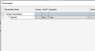

Put your text on 2 different layers, and then you can turn off those layers based on a True/False parameter
ThisDrawing.Document.StylesManager.Layers("Draft").Visible = isDraft
ThisDrawing.Document.StylesManager.Layers("Approved").Visible = Not isDraft
