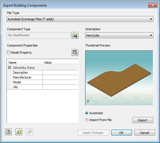

Hi all,
On one of our machines I am getting a warning about the template file not being up to date.  All our standard part/assembly templates are up to date and I don't quite understand what template file is being refered to.
Is there a template '.adsk' file which Inventor uses?
Wayne

Managed to discover that when exporting to '.adsk', Standard.idw is used.
Why? I don't know.
