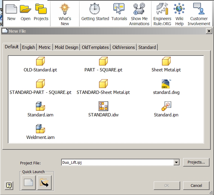

How do I set up the templates in 2013? we just migrated from 2012 and now some of the templates are not showing up. When we installed the vault we created a drive that the vault resides in. The templates also reside on this drive but outside of the vault. in 2012 when  I selected the icon to create a new part/assy/drawing I would get the following drop down menu:

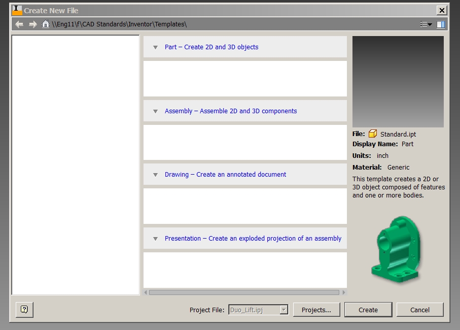

 now in 2013 we have a new and imporved splash screen with more options, I think:
However as you can see, there is nothing to choose. If I use the drop down arrow there is some help, but not much as I have the 4 standard part, assy, drawing and project icons appear. We have used the options menu and changed the file search paths to point to our template folder but we still do not have any options in the new menu and the drop still does not show options for sheetmetal or square parts. The drawing does open with the correct template though. I have also opened each template in 2013 and saved it so it should be migrated to the new format. but that has not helped.

To configure the templates path you can do it as below:
1. Application default templates:
In Inventor 2013 you can setup the default templates from Application Options->File->Default templates.
2. Inventor project templates:
In current active Inventor project, you can set the templates folder from Folder Options->Templates. The Inventor project templates will override the application templates if you change it, as default it will use the same templates as application specifies.

The issue was that even though I went through the above described steps, the templates were not populated in the shown screen. After a couple of reboots, they did start showing up. However now the sheetmetal rule giving the different thicknesses of sheetmetal does not work so I will have to recreate the whole thing.
