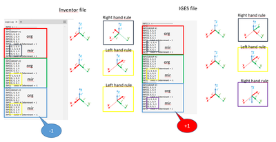

When I use the GetIdenticalBodies command it returns as many ObjectCollections, as many identical solids have been found (and each ObjectCollection contain  the SurfaceBody object and a Matrix object )
I made an example,I draw 3 solids and mirrored them (picture included), and run my code and here is the output I got
Case#1 Red boxes
They are in the same collection ->OK
(the determinant of result matrix equals +1)
Case#2 Green bodies
They are in the same collection, but they are not identical (mirror-symetric)
the determinant of result matrix equals -1 <- I think this value means they are mirror-symetric??
Case#3 Blue cylinders
They are in the same collection, and they are  identical
the determinant of result matrix equals -1 <- WHY???
According to my experiences, this function recognizes the mirror-symetric bodies as identical, and in this case the determinant of result matrix is -1.
But this logic fails with the 3rd case, because these cylinders are identical, however, the determinant is -1
Does anyone have more experience with this function? And can explain the Results
Thank you

my results
GROUP #1
Solid1 # Determinant = 1
Solid4 # Determinant = 1
GROUP #2
Solid2 # Determinant = 1
Solid5 # Determinant = -1
GROUP #3
Solid3 # Determinant = 1
Solid6 # Determinant = -1

Thank you for your answer, I try to describe my problem differently
I made the exact the same transformation all the bodies (mirrored them on the same plane)
but i've got different results, I tried to make a sketch for it below
the real world problem is , I have a multibody skeleton model, and i want to count the identical bodies
#1. My first attempt was to use just the .GetIdenticalBodies function, but it says the mirrored part are identical(but in real, they aren't)
#2. Second, I sorted the result collections by their determinants, which looks good at first, but then I faced this phenomenon (same transformation gives different results(different matrices))
as i interpret it  when the determinant is -1 the orientation is reveresed, (if i transfrom all of the points of the solid by this way that means I will got a mirrored solid, right?)
http://15462.courses.cs.cmu.edu/fall2018content/lectures/03_vectorcalc/images/slide_017.jpg
laszlo_nagy
I exported the sample files to different CAD formats, It turned out if I export it to IGES and import it again then I got good result
I've only done a few tests but I've come to this conclusion somehow Inventor interprets its own circular surfaces differently than the imported ones(IGES OK, STEP also not OK)
