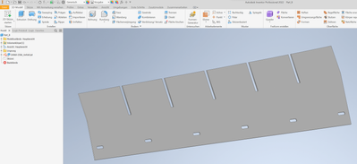

i try to Sort Edges with Shortest Distance to CeneterPoint (0,0,0)

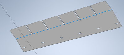

My Goal is to Create SketchLines to Connect all Edges in This Way:
The Edges  are with Length between 81.0 to 81.3mm
Is there a way to sort the Edges with Shortest Distance to CenterPoint(0,0,0)
and then Connect each Bottom Vertex from each Edge with each other.
To get the Result like in Sketch1 ?
