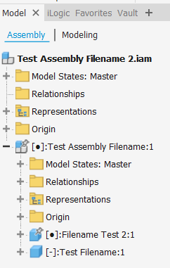

I am struggling trying to use a rule to show both part number and description on the tree.  I used this code I found on the forum:
'create reference to part
openDoc = ThisApplication.ActiveDocument
'format display name
openDoc.DisplayName = iProperties.Value("Project", "Part Number") & " (" & iProperties.Value("Project", "Description") & ")"
openDoc.Rebuild
'update
iLogicVb.UpdateWhenDone = True
But every time I make a save aand replace, it keeps old name and description, and I need to open the part from the assembly and save it again. Inventor also shows errors when using this rule.
Also, what would be the best option to trigger the desired rule? After saving, when changes on the iproperties...

I tried to trigger the rule before saving, after saving, when opening, everytime, but not working.
Just to clarify, I need a rule to show in the tree description the part number (as it works always with Inventor) and also the Description of the part or assembly, so it is easier to navigate when having lots of parts/assemblies, just like this:
The code I tried works OK, it shows part name and description, but:
- When I copy and replace the part "PARTNUMBER_01" to "PARTNUMBER_02", it does not update anything unless I open the part individually, but it changes the Display Name of the main assembly. On the following picture, I just copied PARTNUMBER_01 and saved and replaced it for PARTNUMBER_02:
- Also the partnumber and description of the assembly that contains the copied part changes from what it had to the part number and description of the copied part. This can be solved by saving the assembly, but can be annoying
- Main problem is the fact that rule does not work when save and replace part.
- Sometimes also this error shows up:

Jonnox
Hi @WCrihfield ,
Thanks again for your response. I didn’t know about the "Rename Browser Nodes", definitely will come in use (even more so now I'm messing about with those names!).
Displaying the filename, description, Model State*, Design View* and position view* is a must (* if they are not set to "Master").
Don’t worry about long codes, I'm no expert at all, so if it works, it works! I can just about get the rules running, other than that I'm completely new to this.
I created two test parts and two test assemblies, to make a simply 3 level assembly.
When I ran your code on the highest level "Test Assembly Filename 2", with assembly "Test Assembly Filename" Representation options set to Master, Master, Master.
It displayed the following -
So, this worked as it only renamed the files underneath the top-level assembly, just leaving two brackets displaying.
Would it be able to display "Description" from the iProperties after the brackets?
When I ran your code again on the highest level "Test Assembly Filename 2", with assembly "Test Assembly Filename" Representation options set to Model State1, Default, Position1.
So again, it only changed that level, it shows the model state and the position view, great.
It doesn’t remove the previous text and it’s not showing the design view.
I did the "rename browser nodes" and ran the code again.
it now displayed the following-
No design view text, and the "model state1" is repeated at the end.
The next test I did was to run the code on the sub assembly level (which just contains two single parts)
and it always returns the below -
No text changed in the assembly tree, my guess is because single parts don't have a positional view.
FYI, I'm currently using 2022 but on Tuesday next week I should be upgrading to 2025.
I hope all this information helps!
