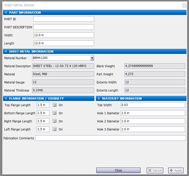

I am creating part templates for some standard sheetmetal sections which will in turn be used by some semi-skilled users to set the material and gauge from the sheetmetal styles and then set various part parameters (say width height and length.
I'd like to open the inventor sheetmetal styles to allow the user to select a predefined style and then once the style is set, defining the material and gauge they will set the part parameters (say Length, Width and Height). See attached JPg for form example.

doug.johnston
I think I have something similar to what you are looking for.
It is a form with custom user parameters that is pulling most of the information from an Excel spreadsheet that was I created.
I do a lot of sheet metal parts, so I created the spreadsheet to match my workplace naming convention "SHEET METAL INFORMATION" section.  All the information is generated from selecting the "Material Number" which gives the "Material Description" / "Material" / "Material Gauge" / "Material Thickness".  The weights are generated from the "Width" and "Length" parameters which ties to a "lbs/sqin" column on the spreadsheet.
Is this close to what you are looking for ??

Hi Doug,
This is very nice and pretty well does most of the stuff I want. Is this done using iLogic or is it VB. Nice solution either way. Is all the material info loaded from your Inventor Sheetmetal style?

doug.johnston
Good morning Richard,
Sorry for not responding sooner, it was a very busy week.
Here is my code where I am reading the excel spreadsheet to get the appropriate parameters.

Here is the Excel spreadsheet (see attachment)  ...
I am using all ilogic in the rule and no VBA code.
Of course, you will have to create your own spreadsheet to match the parameters you want, but it is a very simple program to modify.
After creating the custom iproperties, you can create the form to grab whatever iproperties you want to include.  My form only allows the "MATERIAL_NUMBER" to be selected by the use and all the other values are "greyed out" to show the information only.
I have another couple of rules to calculate "LENGTH, WIDTH and THICKNESS" and "WEIGHT" based on the "WEIGHT SQ_IN" values.+
EDIT - I only use one standard sheetmetal style, so I don't need to change the styles to match my individual materials.
If you would like any more information or assistance, let me know.
Doug J.
