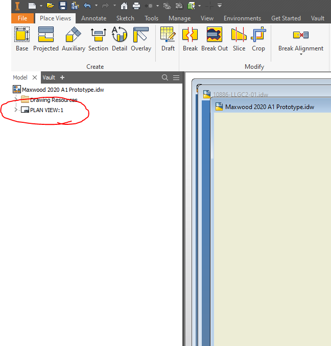

Morning,
I'm a bit lacking in knowledge when it comes to coding. I want to generate the part number as the sheet name (so when I save out a autocad its the correct name)
The drawing number is made up of  4 individual Custom parameters (blue), a couple of 'default' characters and the sheet number.
10000-MWL-C1A-25-DR-X-0001
Custom                       Default    Sheet No
This is the sheet name what I want to input to.
So yeah if anybody as any ilogic code to do that, that would be great. I've attached the file.
Secondary issue; In an ideal world the sheet number would read '0001, 0002, 0010', from what I can see on here that is not possible without we can create a custom parameter from it but that'll be a ballache probably!
