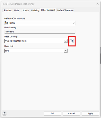

We model some parts that are purchased as 50mm thick rolls (insulation) and need to display the sq meter of the part. These parts vary in size and shape. To do this, we have used the parts volume and divided it by 50(the thickness of the insulation). The issue comes with setting this in the "Bill of Materials" tab under "Base Quantity".
The code is to create the parameters; however, we need to go into the parameter and change the units to "m" before we are able to select the parameter from the pull-down list under "Base Quantity". Once it is selected, close out of the Doc settings and go back to parameters and switch the units back to m^2. Then, back to "Base Quantity," verify the parameter is selected, then use the formula button to select the parameter again. This seems to be the only way to get this to work.

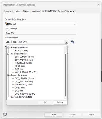

I just gave this a try, and I have the same results. Both parameters are created and Visible in the Parameter window.
When I enter the Document settings>Bill of Materials, I can not select "AREA_INS" from the pull down.
If I select the parameter button, I can see all User parameters, including "AREA_INS". If I try to select "AREA_INS" nothing happens. The value does not change in the pulldown.
Andrii_Humeniuk
There can only be one Base Quantity for each element, if you need to set the AREA_INS parameter then you need to use the following code:

Also in inventor there is a problem with setting area as the base unit, but it is not impossible. This topic describes a method that allows this.
In the code, I implemented this capability by converting the unit of measurement to length and then to area.

Yes, I understand there can be only one. This one works great. Thank you very much.
