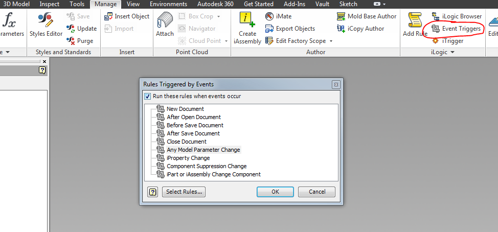

Hello All
I'm trying to use iLogic to modify a pipe.
I have a "user Parameter"
"DN" = 0
I've made a new Rule
"Dimension"
containing

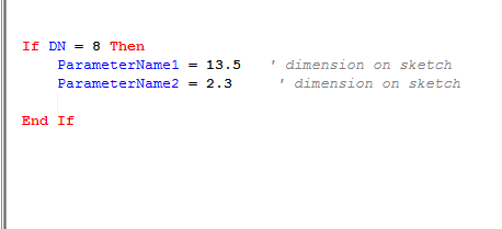

If Parameter("DN") = 8 Then
    Parameter("d14") = 13.5   ' dimension on sketch
    Parameter("d13") = 2.3     ' dimension on sketch
end if
Is it possible to run the rule when the "user Parameter" is modified? and how?

You can set an Event Trigger to tell your rule to run on Any Parameter Change.
Manage Tab > iLogic Panel > Event Triggers
Or Instead of using Parameter("DN"), just use the parameter name.  If you just use the parameter name, the rule will run whenever any of the parameters in the rule are changed.
^_^clovis^_^
Thanks a lot!
