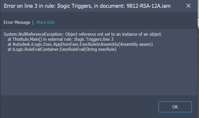

Message 3 of 10
spanky
Any idea whats causing this? @Andrii_Humeniuk - I'm running 2023 version if that matters.
Message 4 of 10
WCrihfield
Hi @spanky.  It looks like the first line of code just needs to be updated like this:
Dim oInvApp As Inventor.Application = ThisApplication
  Whenever I hear about someone wanting to copy internal iLogic rules to a lot of other Inventor files in their file system, I cringe a little, because I went through some of that process early on (several years ago), and later had to clean all that up again.  Is this internal iLogic rule named "EXTENTS_MODEL" identical within all of those different documents?  If so, why not use a single external iLogic rule instead?  You may simply need to review how the external rule version specifies the document that it is supposed to be working on (usually with the 'ThisDoc.Document' phrase).  You can have external iLogic rules be triggered by events in the 'This Document' tab of the Event Triggers too.  You could also have the external rule triggered to run by one of the events on another tab, so that the Event Triggers of every individual file does not need to be modified.  If the external iLogic rule is triggered to run by events on another tab (not the This Document tab), you may then need to use the 'ThisDoc.Document' term, instead of the 'ThisApplication.ActiveDocument' term within your external rule to identify the document it is to work on, then include a little code to inspect that document to make sure it is one you want it to work on, before the code does its main task.

@WCrihfield @Andrii_Humeniuk

This error is possible if there are no triggers in your template file that can be copied. A simple (temporary) solution might be to add a try-catch.
Here are two more logical methods for you to replace. I hope they will work, because unfortunately I don't have the opportunity to test them (I don't have Inventor at home).
