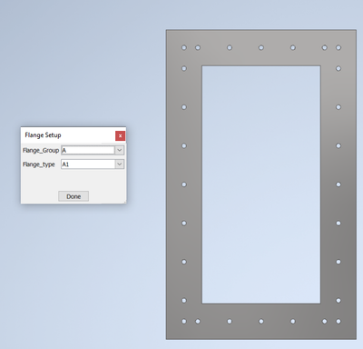

I made a rule which changes a flange according to selected type and sub type using Case function.
The issue is that when I change the type model doesn't update fully unless I change the subtype also.
Below is the code:

Setup ASetup ASetup B after I change to itSetup B after I change to itActual Setup B after I switch to B2 and back to B1Actual Setup B after I switch to B2 and back to B1

DRoam
Try adding the following line to the top of your rule:
iLogicVb.UpdateWhenDone
Sometimes iLogic will change parameters and things but the model doesn't update accordingly until it's told to do so.
eugen.gutol
I've added at the end
iLogicVb.UpdateWhenDone = True
but it didn't change anything
Separate it to 2 rules.
GroupRule with with Flange_Group Select
TypeRule with with Flange_Type Select
That should work
eugen.gutol
That's the thing I don't want to split it to several rules. There will be other rules with similar structure and I don't want to have a rule for every 5-6 features.
I have a workaround:
Add a blank position on your list on first position. Then you'll be forced to change it every time you change flange group. And selecting a blank position will make no change, so it's not a problem.
MultiValue.SetList("Flange_type", "A1", "A2", "A3")
change to
MultiValue.SetList("Flange_type", "", "A1", "A2", "A3")
