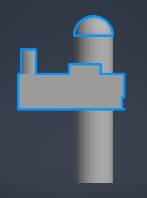

J-Camper
Does anyone have a working example of this Method:
TransientBRep.CreateSilhouetteCurve Method
I'm trying to capture the overall outside profile of a solidbody, viewed from a particular direction.  I was hoping to keep everything transient and this looked like the right method, but I can't get any results from it.  It always returns nothing with my tests.
I want to know if anyone is willing to share an example for how to use this, or if you have any other suggestions for capturing the overall profile of a solid view from a direction, I'm open to trying a different route.

Stakin
Are you want this?Draw an outline at any view position;
Message 10 of 15
Stakin
Try below,But it sometimes crashes and doesn't output. I don't know why this is so, it needs to be solved by a master.
If something goes wrong, Change view to another perspective.
The error is mainly that all sketch profile outlines cannot be selected when extrude at certain angles in the function of 'oSketchEnt', and the reason maybe  some sketch lines intersect but do not have a clear intersection point; As a result, an effective closed profilepath cannot be formed.It is hoped that a master will solve it.

That does not seem to provide the same outline graphics as native user selected outline:
CodeCodeUser SelectionUser Selection
I only want lines that represent boundaries of the actual solid, nothing extra.  This image is the intended output, crudely mouse drawn:
Crude representation of end resultCrude representation of end result
With that being said, I am changing gears from this approach for my current project.  I would still like to figure out how to capture something like this, but I'm not including this workflow in the project I'm currently working on anymore.

By now,to be this effect by clientgraphics
it can check at any view direction.
