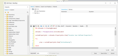

I hope you can find this useful, even if it is not exactly what you are looking for, because the rule finds the view rep used on the assembly in the first view on the first sheet of the drawing, and it doesn’t work with the View Label anyway.
The rule creates an iProperty called "ActiveViewrep" in the IDW (not in the assembly).
You need to add that iProperty to any drawing text, or, for instance to the titleblock.
You will see the correct result ONLY when you run the rule MANUALLY or when you save the drawing after you have added this rule to the Event trigger called "Before Save document".
Here is the rule that needs to be placed in the drawing template file.
Dim odrawdoc As DrawingDocument
odrawdoc = ThisApplication.ActiveDocument
customPropertySet = odrawdoc.PropertySets.Item("Inventor User Defined Properties")
Try
      prop = customPropertySet.Item("ActiveViewrep")
Catch
      customPropertySet.Add("", "ActiveViewrep")
End Try
Try
iProperties.Value("Custom", "ActiveViewrep") = odrawdoc.Sheets.Item(1).DrawingViews.Item(1).ActiveDesignViewRepresentation
Catch
End Try
InventorVb.DocumentUpdate()
Kind regards,

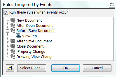

Didn't work for me..?? My assembly was an iassembly.. Not sure if that matters. I placed a base view, view rep was "assy op 10". View label was turned on and associative check box is selected..view came in as "View1". Hit the add rule button, pasted all your code into it and hit ok. Set a trigger to fire that rule before save event. Nothing happened.. View is still labeled "View1"

Where would I put this code within Inventor 2024 for the BeforeSave event trigger?
Message 17 of 17
WCrihfield
Hi @WP_Australind.  I am not sure I understand the question...what do you mean by "when"?  Do you mean how?  If you meant how, then go to the Manage tab, then to the iLogic panel, and there should be a button named "Event Triggers".  When you click that a dialog will pop-up with 5 tabs across the top, two areas on the left, and one large area on the right.  You usually want to be on the tab named "This Document", because stuff on that tab will only effect that one document, and no others.  The top area on the left has internal rules listed (rules that are saved within that document, if any), and the lower left area will contain your external iLogic rules, if any.  You can drag one of those rules from the left to the right, and put it under the event named "Before Save Document".  Then click the OK button.  Then whenever you save that one document, it will automatically run that rule just before it saves each time.
