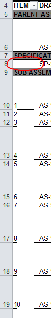

AlexFielder
So it seems I have answered my own question; Inventor is quite happy for you to have Bill of Materials items with no item number (circled below):
But the thing to remember is to uncheck the "group" option in the parts list should you place a parts list on a drawing.
