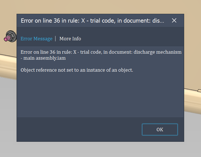

I'm starting work on this piece of code. It works fine on Assembly documents but throws this error on Weldments. What am I doing wrong?
Thank you much!

Hi @emanuel.c.  Not all components in a weldment type assembly will have a referenced document associated with them.  If there are any welds in that weldment, then there will be at least one component that just represents the welds in that assembly.  You can filter for components like that by using a line like:
If oOcc.Suppressed = False AndAlso _
(TypeOf oOcc.Definition Is WeldsComponentDefinition) Then
You first need to make sure that the component is not suppressed.  If it is suppressed, then accessing its oOcc.Definition property will throw an error.  Once you are sure it is not suppressed, then check its definition type.  There are many 'sub types' of a ComponentDefinition (see Derived Classes notes on that linked help web page).  One of those derived types is a WeldsComponentDefinition.  That will not be like other normal components, and you should not try to get what document it references, like you would with some other component types.  I usually also filter out the virtual type also (VirtualComponentDefinition), because they will not be referencing a document either.  They are just for adding another line item into your assembly's BOM.

Thank you Wesley! Also with some help from here I have it working now.
