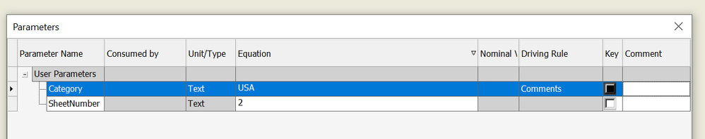

1) Separated the output in two columns. One is for the SheetName, another for SheetNumber, so they are aligned to the left.

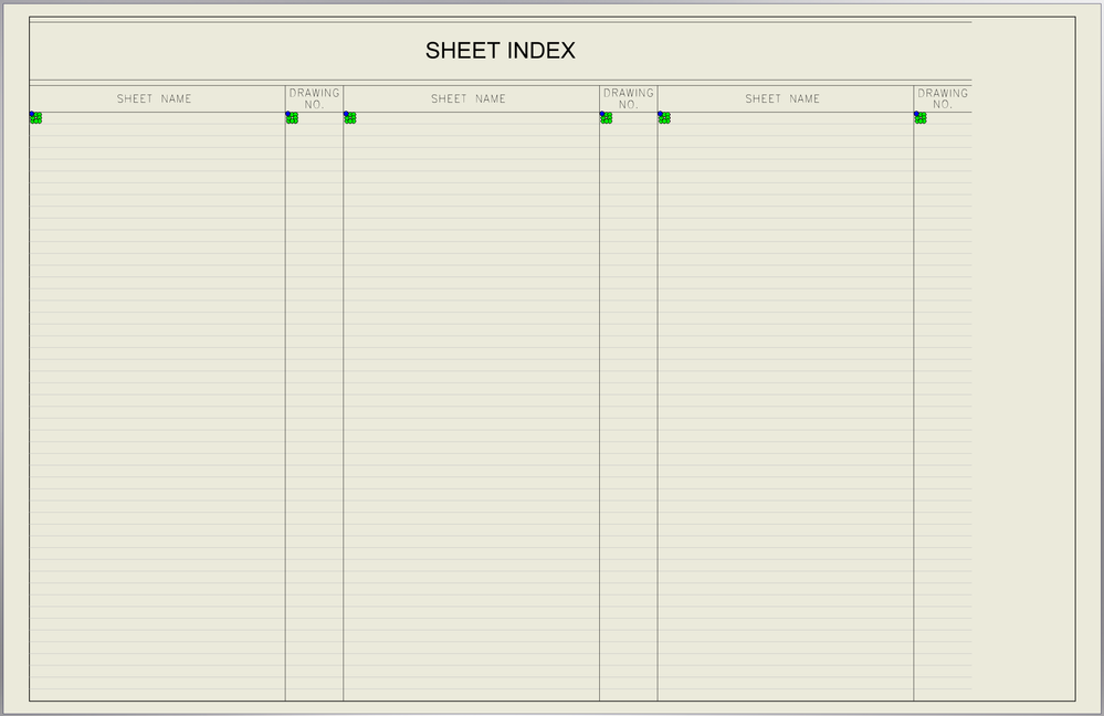

2) I created a Sheet with a grid using Sketch Symbol, placed on an empty sheet, placed the 6 notes on the first row, and then created a Sheet Format on my template.

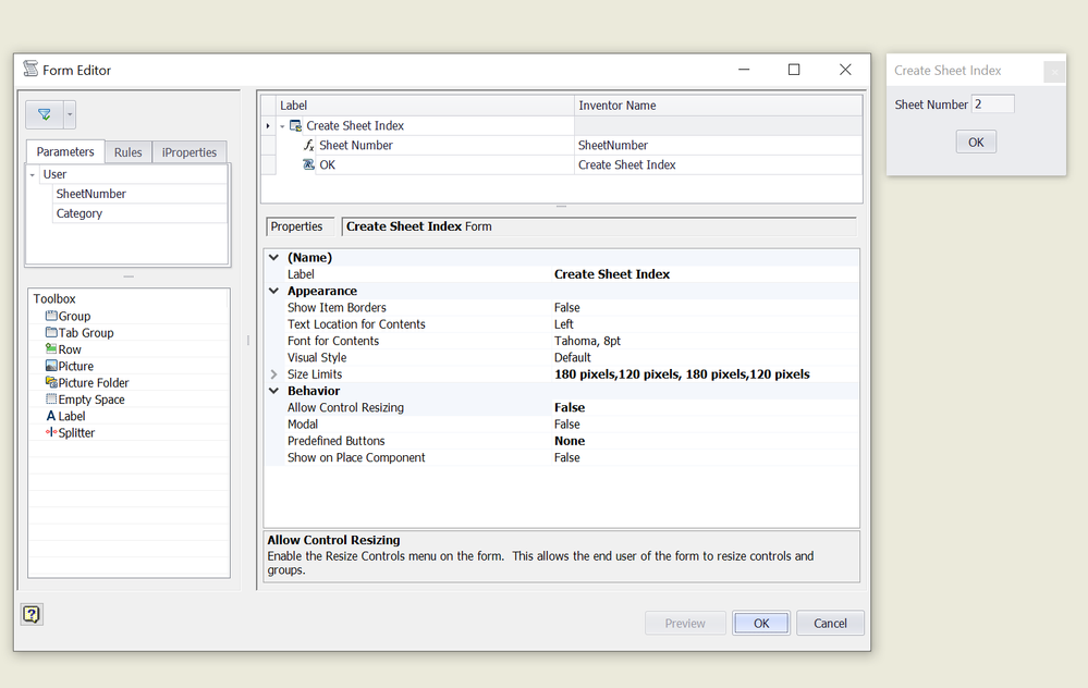

3) I created a form to input the Sheet Number referencing to the actual Sheet Index. I still have to input it manually, cause it can change from set to set. Usually it is sheet 3. The form runs the iLogic when you press ok, the input is carried over a parameter called SheetNumber and the rule reads the number from that parameter.
4) On the sheet index, there are 6 notes:
myNote1 = Sheet Name, from 1 to 50
myNote2 = Sheet Number, from 1 to 50
myNote3 = Sheet Name, from 51 to 100
myNote4 = Sheet Number, from 51 to 100
myNote5 = Sheet Name, from 101 to 150
myNote6 = Sheet Number, from 101 to 150
5) The code reads the sheets quantity and applies it accordingly.
